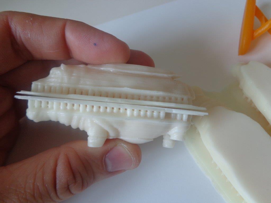

2014-08-07T06:33:20-04:00 2014-08-07T06:33:20-04:00 https://buildyourownsla.com/forum/viewtopic.php?t=1662&p=4556#p4556 <![CDATA[Re: First prints!]]> I'll post some pictures of my failed print later.
In addition to the inverted pyramid, try printing a simple ring( let's say 15mm diameter and 2mm thickness), you will notice that it is way thicker on the top and bottom than on the sides, due to bleed through.

2014-08-06T07:09:53-04:00 2014-08-06T07:09:53-04:00 https://buildyourownsla.com/forum/viewtopic.php?t=1662&p=4534#p4534 <![CDATA[First prints!]]>
