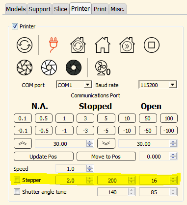

- You need to adjust the screw pitch inside Printer tab. AFAIK, LittleRP has 8 mm pitch, 200 steps per revolution, and 8 microstepping. So you can choose the three values 8.0 / 200 / 8. Please advise me this is not correct.

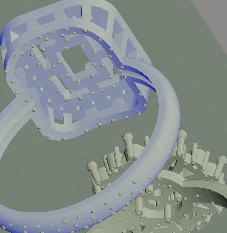

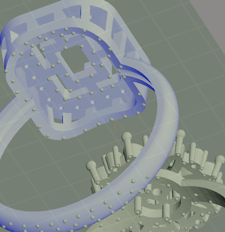

- Added support view option: full support vs. contact only draw (Key shortcut: V)
- Added a feature for adjusting support contact point and size (Shift + Rightbutton)

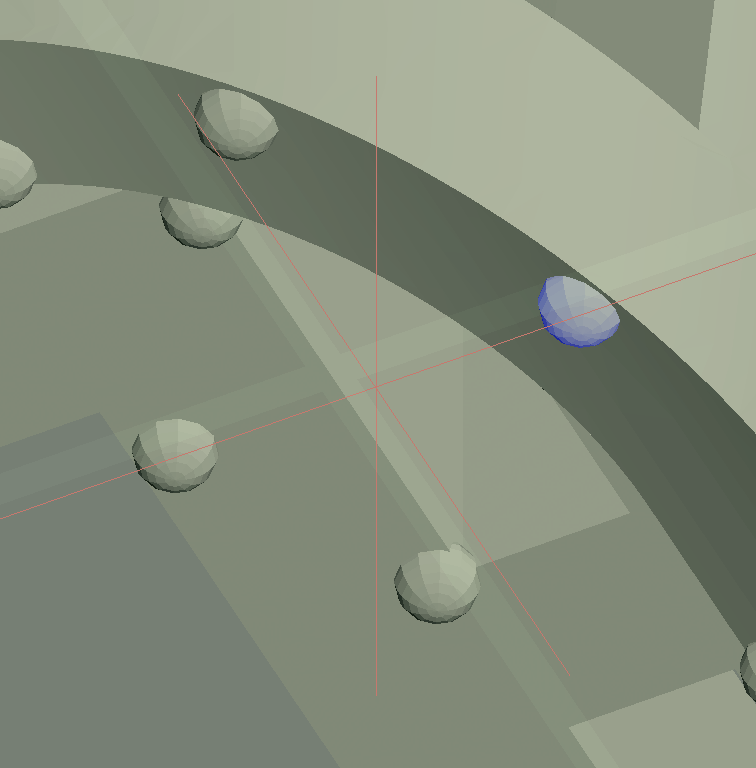

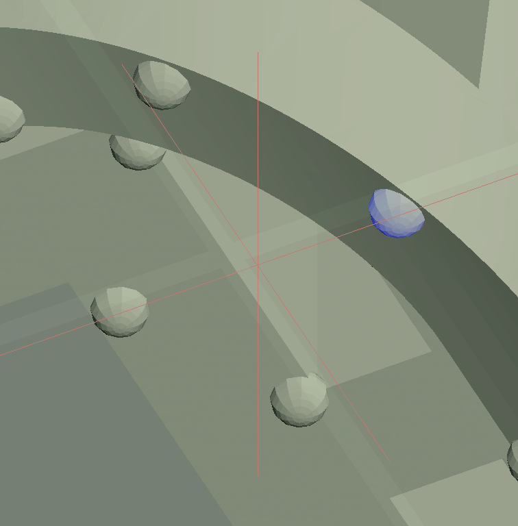

You can toggle the support view option between full drawn supports and contact only supports
Each support contact points can be adjusted after selecting the support.
Right button down and move to adjust position, and SHIFT + right or left button increases or decreases the support diameter by 0.1 mm.
Using these feature, you can precisely edit the supports after rough placement.
