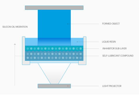

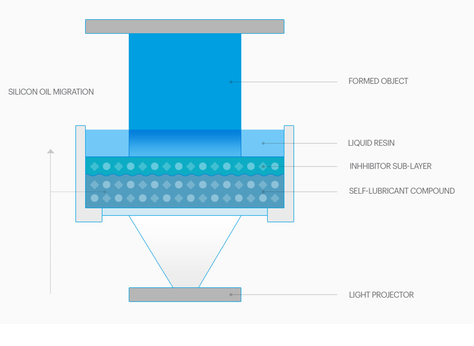

I had some silicone oil laying around so I did an experiment. I put a small amount of silicone oil in a container and added MJ SubG. The SubG immediately settled to the bottom. After a short while the mixture was SubG at the bottom/layer of small bubbles/silicone oil. So looking at the NX1 I assume they have silicone oil (at the bottom)/permeable membrane/UV resin. I wonder what the permeable membrane is?
Dan - mUVe 1 DLP
Phife
- Posts: 239
Re: First Fast 3D Printer?
Did anyone notice that this special oil layer needs to be replaced every 250ml of resin? That seems quite often and probably could add up in cost pretty quickly..

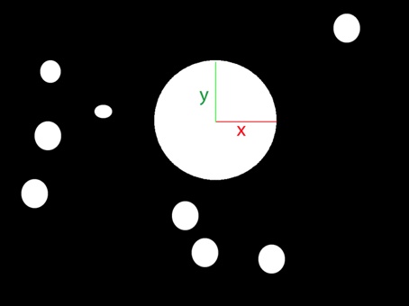

I will try to describe the process as simply as possible, and there are obviously certain details that we can't divulge because they form part of our trade secret, such as the formulas of our films and resins, and how they are combined. Having said that you obviously need a clear idea of the printing quality that you get with our technology, but I hope you can appreciate how delicate some of this information is.
The answer to many of these questions lies in an understanding of the operating process of our LSPc technology, and especially in the time equation… First of all, you need to understand that our time equation is the result of our method, not the method itself!!

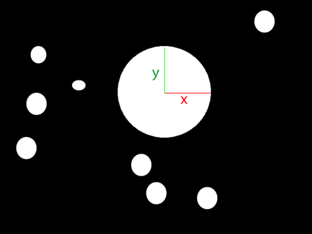

Unlike normal SLA/DLP printers, our printing time involves two speeds: the speed at which the new portion of resin sets (curing time - tp), and we all know about this and it's clear to everybody, and the speed at which the resin penetrates between the self-lubricating film and the recently formed object (refresh time - tb). We need this new parameter because we have dispensed with the tilting system that's typical of other printing methods, so we have to “wait” for the new liquid resin to penetrate! This second parameter depends on many factors, and here is not the place to list them all.
This is why we have a Partially Continuous Sequential System… if the refresh time of the resin is longer than the setting time… the machine has to “wait” for the new layer to get soaked in liquid resin… if, however, the refresh time is shorter than the setting time, the printer can form the object continuously, in other words, without layers!!
So having established that the setting time is constant in relation to the thickness to be solidified, why does our printing speed vary? Why do our videos show objects with holes?
The refresh time depends on many factors, but especially on the dimensions of the individual surface that we have to create for each individual layer… take a look at the example…

in this case, the speed at which this layer is formed is influenced by the larger surface area; the setting time is the same for all the surfaces, but the refresh time is not. In fact, the larger the largest surface, the longer the refresh time.
When the surface area of each layer is sufficiently small that the refresh time is less than the setting time, we can reach printing speeds of even more than one centimeter per minute… and this is all managed by our software.

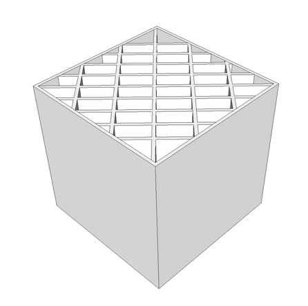

If we were to print a smooth, thin, unperforated surface, as we would if we were forming products made of plastics (this is always true, not just for 3D printers), there would be no problem.

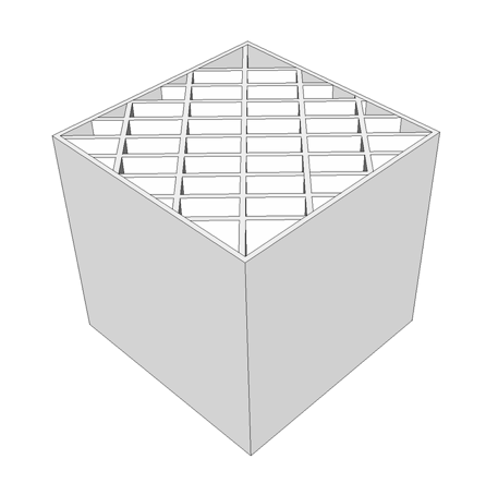

Some people have asked me if our technology is capable of printing a solid cube. The answer is yes, but it would be slower (up to 3-4 minutes per cm), it would use a lot of resin … and use a lot of self-lubricating film.
In my opinion, and our software will suggest this to you, a solid cube should be printed in this way, correctly assessing the structural characteristics of the resin… when we build a house, we don't make everything out of reinforced concrete, only the load-bearing structure!!!

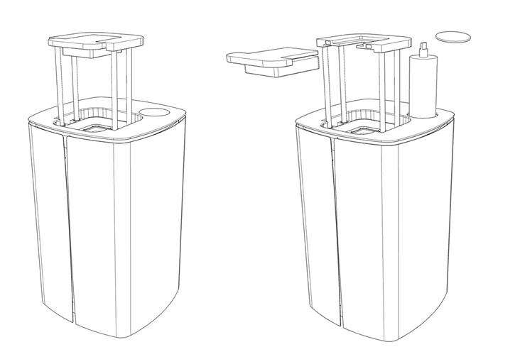

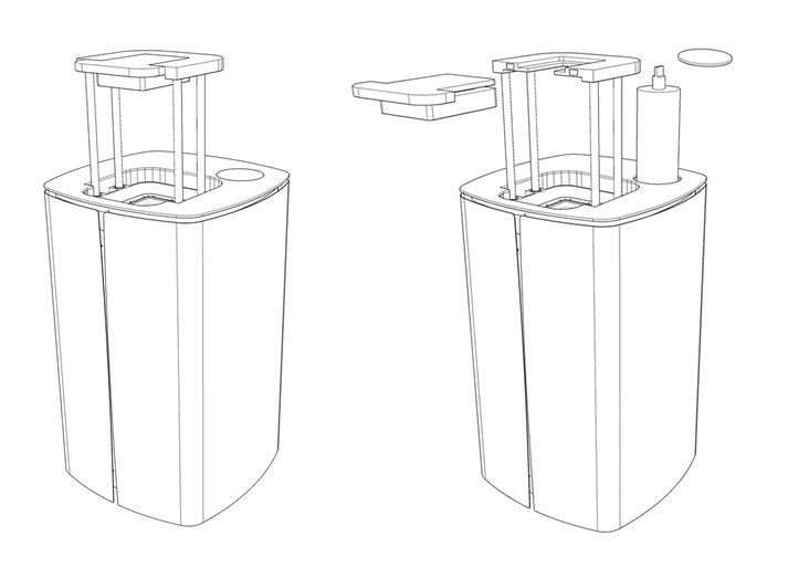

With regard to the last question about enclosing the printer, let's try and visualize the full-blown revolution we are aiming to set in motion… all those problems that people used to have when it took took 8 or 10 or 15 hours to print an object are a thing of the past… you no longer have the problem of covering the printer with an enclosure… or problems of bulb life! This printing speed truly revolutionizes the concept of 3D printers, even from a technical point of view. If we had not achieved these levels of performance, the design of the NX1 could not have been what it is either!!
Our aim and our dream are still the ones we established for our launch… we want to change people's perception of what a 3D printer is… and in our opinion, it should be fast, smart and affordable!!
