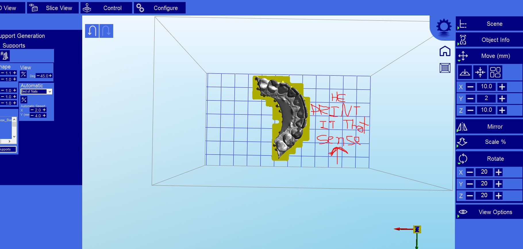

Hi friends, I bought the KLD LCD 1260, and I have a problem.
I'm using the creation workshop and the impression is coming out inverted the position of the piece, as I show below. Can someone help me solve this problem? Thank you very much in advance.
